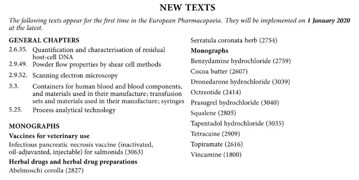

新增内容:
The following texts appear for the first time in the European Pharmacopoeia. They will be implemented on 1 January 2020at the latest.
新增以下章节,它们最迟将于2020年1月1日生效!
2.6.35. Quantification and characterisation of residual host-cell DNA
残留宿主细胞DNA的定量和定性
2.9.49. Powder flow properties by shear cell methods
剪切细胞方法检查粉末流动特性
2.9.52. Scanning electron microscopy
扫描电子显微镜
3.3. Containers for human blood and blood components, and materials used in their manufacture; transfusion sets and materials used in their manufacture; syringes
用于人体血液和血液成分的容器及其制造中使用的材料;输血套及其生产物料;注射器
5.25. Process analytical technology
过程分析技术

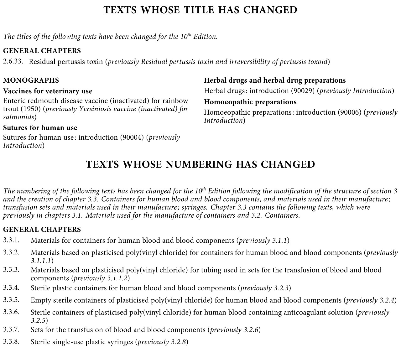

5.3. Statistical analysis of results of biological assays and tests
生物含量结果的统计分析和检验
5.8. Pharmacopoeial harmonisation
药典协调
5.21. Chemometric methods applied to analytical data
应用于分析数据的化学测量方法
5.22. Names of herbal drugs used in traditional Chinese medicine
中药用草药名称
5.24. Chemical imaging
化学成像

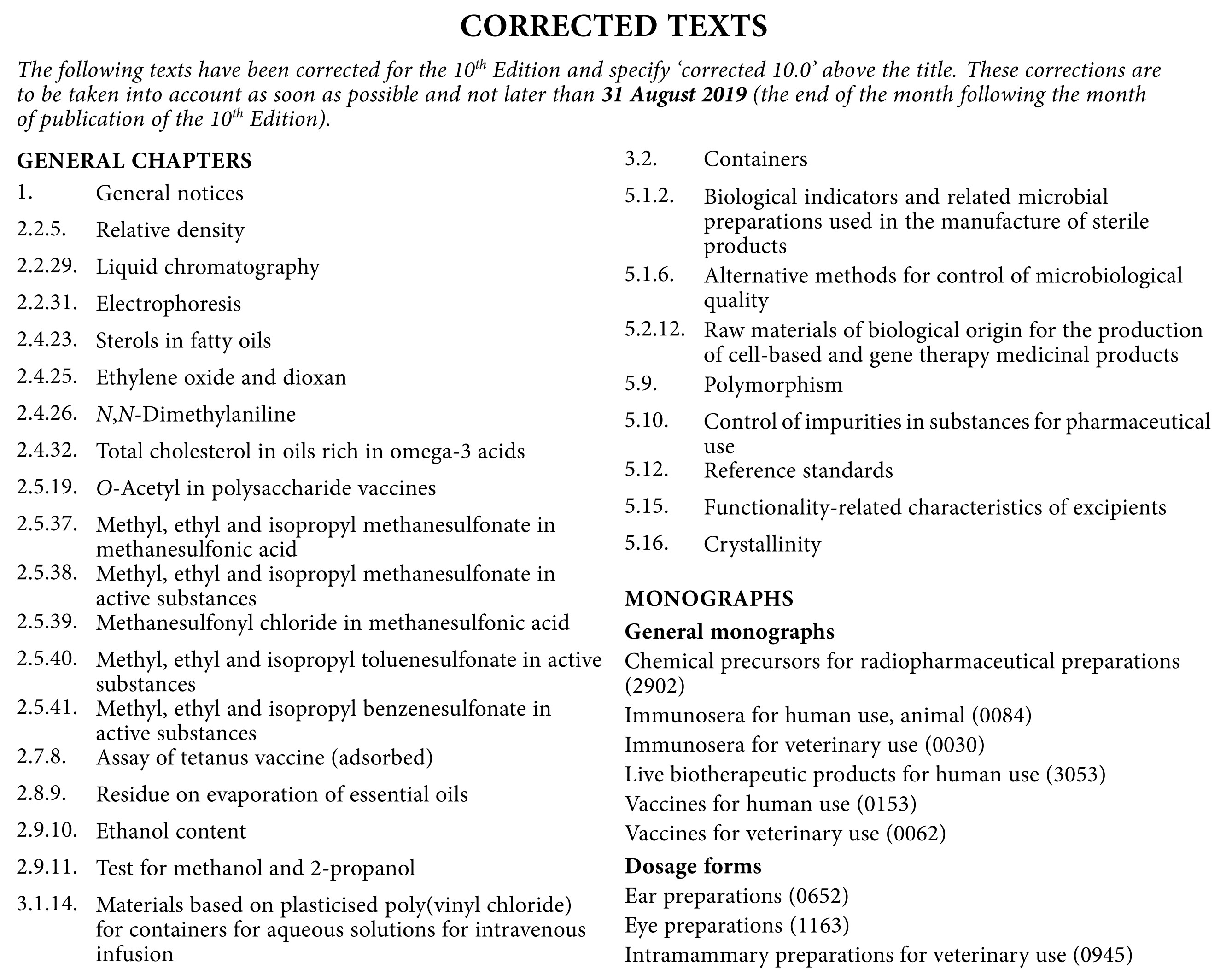

修正的部分
The following texts have been corrected for the 10th Edition and specify ‘corrected 10.0’ above the title. These corrections are to be taken into account as soon as possible and not later than 31 August 2019 (the end of the month following the month of publication of the 10th Edition).
以下章节作了修正,并在其标题上标注了“10.0版修正”应尽快考虑这些修正,并最迟不得迟于2019年8月31日。
1. General notices
凡例
2.2.5. Relative density
相对密度
2.2.29. Liquid chromatography
液相色谱
2.2.31. Electrophoresis
电泳法
2.4.23. Sterols in fatty oils
脂肪油中的甾醇
2.4.25. Ethylene oxide and dioxan
环氧乙烷和二恶英
2.4.26. N,N-Dimethylaniline
NN-二甲基苯胺
2.4.32. Total cholesterol in oils rich in omega-3 acids
富含欧米伽-3酸的油中的总胆固醇
2.5.19. O-Acetyl in polysaccharide vaccines
多糖疫苗中的O-乙酰
2.5.37. Methyl, ethyl and isopropyl methanesulfonate in methanesulfonic acid
甲磺酸中的甲基、乙基和亚丙基磺酸
2.5.38. Methyl, ethyl and isopropyl methanesulfonate in active substances
活性物质中的甲基、乙基和甲磺酸异丙酯
2.5.39. Methanesulfonyl chloride in methanesulfonic acid
甲磺酸中的甲基酰氯
2.5.40. Methyl, ethyl and isopropyl toluenesulfonate in active substances
活性物质中的甲基、乙基和甲苯磺酸异丙酯
2.5.41. Methyl, ethyl and isopropyl benzenesulfonate in active substances
活性物质中的甲基、乙基和异丙基苯磺酸盐
2.7.8. Assay of tetanus vaccine (adsorbed)
破伤风疫苗的测定(吸附)
2.8.9. Residue on evaporation of essential oils
精油蒸发残渣
2.9.10. Ethanol content
乙醇含量
2.9.11. Test for methanol and 2-propanol
甲醇和2丙醇的检验
3.1.14. Materials based on plasticised poly(vinyl chloride) for containers for aqueous solutions for intravenous infusion
用于静脉输液容器的塑料聚合物(氯乙烯)材料
3.2. Containers
容器
5.1.2. Biological indicators and related microbial preparations used in the manufacture of sterile products
用于无菌产品生产的生物指示剂及相关微生物制品
5.1.6. Alternative methods for control of microbiological quality
微生物质量控制的替代方法
5.2.12. Raw materials of biological origin for the production of cell-based and gene therapy medicinal products
生产细胞和基因治疗药品的生物原料
5.9. Polymorphism
多晶型
5.10. Control of impurities in substances for pharmaceutical use
药用物质的杂质控制
5.12. Reference standards
标准品
5.15. Functionality-related characteristics of excipients
辅料的功能相关特性
5.16. Crystallinity
结晶性
此外,还有一部分修改了标题和编号。
